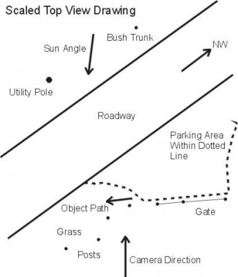

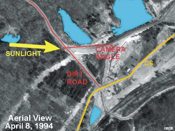

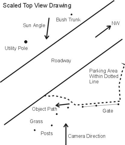

1) To arrive at accurate positional information and grades of the area, topographical maps, USGS online satellite maps, and sun angle data were first consulted. The following data is important for further calculations: Roadway direction, at the objects location, heading away from highway C6 = 317°, Sun azimuth at 6:30 PM, 08/02/92 = 274°, Sun altitude at 6:30 PM, 08/02/92 = 23°, Camera filming direction = 263°, Main road grade downhill towards C6 = 8.7%, Up hill slope of the woods beyond the main roadway = 20%, Altitude drop from roadway to camera = 10 feet. All directions are referenced to true, geographical north, as being zero degrees. Refer to the Aerial View below for illustration.
2) Actual site measurements were used to confirm the above data and prepare size and positional information of the trailhead gate, posts, utility pole and other landmarks in the area. The location of the camera as stated by the filmmaker, of 282 feet from the 12-foot bush opposite the parking area, was located and the general view seen on the documentaries confirmed. The original camera position and time of filming stated by the filmmaker is considered accurate, and can be verified by combination of the following: the angle of the trail visible in the documentary, the angle of sunlight shadows of nearby bushes, the apparent size of the utility pole when filmed with the stated camera, the general view of the pond at this location, the view across the pond of a utility pole and tree in some of the video clips – allowing triangulation, and the general view of the roadway landmarks such as posts and poles. The distance from the camera, in the direction of the object in question, to the far side of the roadway will therefore be = 282 feet for further calculations; however, an error of 10 feet here only affects the object size by a few percent or 2 to 3 inches. Incidentally, present day measurements, of the fence posts along the roadway and partially visible in the film, do not all agree with the 1992 positions even when rotated to the proper viewing angles. Either, at least one post has been altered in the last 8 years or what appears as a post is the film is really a result of poor resolution. Other more suitable objects were chosen for size reference due to the questionable accuracy of the post positions in 1992. It is indicated in the documentaries that some alterations have been made to the soil surrounding the posts to keep out ATVs.

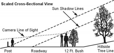

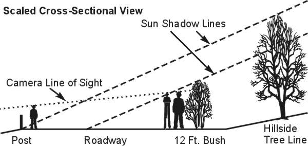

3) The exact position of the object in question can be located by agreement of the following deductions. See the illustration of the Cross-Sectional View of the area. Note, the sun altitude is only 23°, the 12-foot bush that the object is stated to be adjacent to will therefore cast a shadow 28.2 feet long across the roadway. Since the object is obviously being illuminated by sunlight (see section 4) below) from at least the waist up, the stated 8 to 10 foot tall Bigfoot cannot possibly be closer than 16 to 20 feet from the bush. When the shadows of taller trees on the hillside are accounted for, their height calculated by reference to the utility pole and the known hill slope, and also viewable onsite, the shadows extend a minimum of 40 feet across the roadway. The observed object’s lighting conditions then place it at a minimum of 30 to 40 feet from the far side of the roadway, which is in the parking area. Of course, the exact shadows are not the same as in 1992, but the general figures obtained from the film make it impossible to place the object at the far side of the roadway. Additionally, the zoomed images clearly reveal that the side of the individual is seen and that it had to turn to look in the direction of the filmmaker. Referring to the illustration of the Top View Drawing, it is easy to see that the individual would reveal a much larger frontal profile if walking at the oblique angle of 54 degrees on the roadway. In contrast, the area near the posts is perpendicular to the filmmaker resulting in the side profile evident in the video. The individual would be about a foot taller if it were located on the far side of the roadway instead of at the posts. The accuracy of the size measurements indicated in section 7) below add even more certainty that the object is located by the posts in the parking area. We will therefore use 225 feet as the distance from the object in question to the camera in further calculations; again noting that a 10-foot error would only result in a 2 to 3 inch size error.

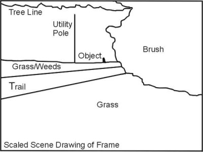

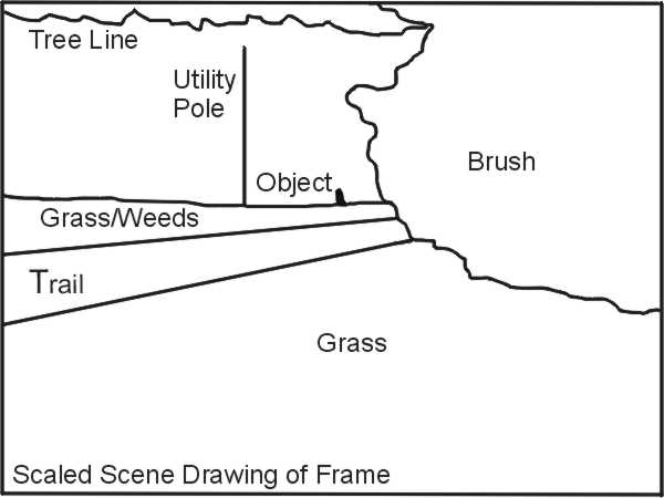

5) The next important step, after all object positions have been deduced and verified, is to find a way to correlate the object size and position on the video images with actual physical dimensions. This requires a known-sized object that can be identified on the film, unless the original camera used is available for inspection. The selected object should be as large as possible to avoid errors in measurement due to blurring of the video images. The blur or edge definition based on the specifications of the camera in use at 225 feet is 3 to 4 inches. A 35-foot long object would be required to obtain 1% measurement accuracy. The height of the viewable portion of the utility pole, up to the top insulator, which is gleaming in the sunshine, was selected. A viewable distance of 43.0 feet was measured while onsite; this was also verified with our onsite video recordings made from the position of the filmmaker – using a technique based on camera angle. After a few calculations including a correction for viewing angle error, the scale factor of our captured images is 0.04418 inches/foot at the poles distance. As a quick check, the pole diameter of 12 inches at the height compared to on the video agrees very closely with this figure. At the 225-foot object distance, the scaling factor is 0.05341 inches/foot. Now it is easy to zoom the captured image as needed, and use the computer tools to measure the object in question and the distance it moves. Since the images were digitally captured, the aspect ratio is perfectly maintained and not subject to the height and width adjustment uncertainties of a TV or monitor. Another technique that can work almost as well is to make a few calculations when the camera’s viewing angle is accurately known. Although the original camera was not inspected, the viewing angles that correspond are very typical of video cameras of their class. For example, our latest Sony has a 34°H and 26°V as measured for reference right off a wall with a tape measure.
6) Most of the raw measurements made above will require some additional processing before actual results are available. Some of the data was taken from the zoomed portion of the documentary as mentioned above, so it was necessary to find the magnification used during the process. Simply by taking a visible reference from a zoomed and un-zoomed frame, this can be calculated to be = 2.1428 for future reference. Incidentally, the un-zoomed portions of the documentary were actually filmed at a zoom of 12%; this becomes evident from viewing the end of the last un-zoomed clip in the ’95 version. All object positional data was referenced to the insulator on the utility pole; this prevents camera motion from causing optical illusions and errors in measurement. The furthest point away from the camera is also always the best reference point; nearby objects will move with the camera position creating optical illusions. In addition, the image data points were corrected for camera rotation from frame-to-frame. The center of the objects head was used as the measurement point to best determine its position. The center is best due to the blurring associated with the edges. The distance the object traveled must also be corrected for the angle difference between the objects path and the camera’s viewing direction. In this case all evidence indicates this angle is less than 10 degrees and only a 0.5% error results if the effect is ignored. It should be pointed out, that by carefully plotting the scaled data on a large sheet of paper, and graphically solving by making measurements directly off the paper, one could avoid many of these calculations and not require computers or training in mathematics. Now, the objects path can be transferred to the map that was prepared onsite of the area. It is now evident that the calculated results agree perfectly with the view from the filmmaker’s video. This important test can reveal a calculation, deductive, or measurement error if agreement is not obtained. When your deductions and data agree with the viewable information, the hypothesis is thus confirmed. See the illustration of the Object Path in the Top View Drawing.
7) Another important value that can be determined from analysis is the object’s size. The object size was determined by making careful measurements of the various body parts visible in only some of the zoomed frames. The measurements possible were head height, head width, upper arm length, body side width, head to shoulder, and head to wrist. Care was taken to avoid measuring the blurred regions, but this proved to be difficult in all but one type of measurement. The best data points would normally be those that span the greatest distance. In this case, only the head-to-shoulder measurements were considered accurate due to the blur cancellation they afforded. Human anthropometric data from several sources were compared for accuracy, and then used to form scaling factors for converting the body segment lengths to overall body height. Note, that the use of Ape or other data would result in a much smaller height due to the proportionally longer arms and head. Also note, the head position relative to the shoulder is consistent with human values. The data was then imported into an Excel spreadsheet for scaling and statistics. As an indication of measurement accuracy, the standard deviation was also calculated for each body part from the multiple frames. The height of the post where they intersect the body of the individual was also used in the body height calculations, using the proper anthropometric data. The post-intersection technique resulted in a slightly taller individual, but the method was more prone to error. The true post heights, referenced to the parking area soil, were previously measured onsite. Based on the above data, if the object is incorrectly located on the far side of the roadway, it would be a foot taller as noted in section 3), but then the head would still just barely protrude above the post tops. The posts appear about 6.3 feet high when projected to the far side of the roadway, due to the camera’s up-hill line of sight. Since the waist level, in the video, is in line with the post tops, the 7-foot tall creature would have legs almost 6 feet long – ridiculous proportions. Note, the upper body proportions are not abnormal in the film and agree closely with normal human proportions. The only other possibility is that the creature is over 10 feet tall, but the measurement accuracy obtained cannot support that possibility. The head of a creature that large would be almost twice as wide as the utility pole when blur is accounted for, which is not evident in the film; other body parts would likewise appear much larger. These observations are more very good reasons to exclude the possibility that the object is on the far side of the roadway; this can also be demonstrated onsite. See the Cross-sectional View for illustration of these effects. Placing the object beside the posts in the parking area avoids all of these types of contradictions.

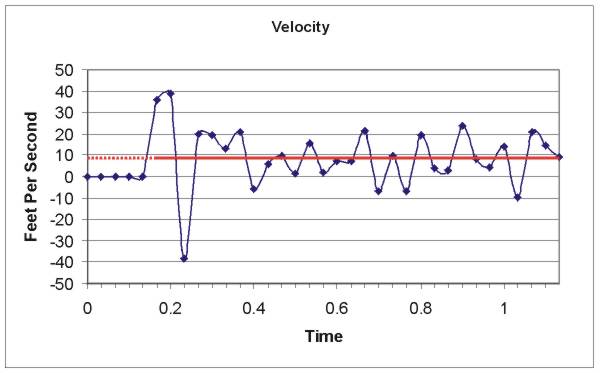

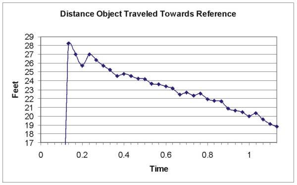

This section will present the analysis results and also compare them to the claims made by the filmmaker. Over a period of almost exactly 1.00 second, the object is seen to move into viewable position from the right side, behind the foreground bushes, and proceed to the left until becoming obscured by roadside brush. After 0.33 seconds, the object reappears at the same location for an additional 0.166 seconds until the camera is rapidly moved away from view. About half of the time the object is visible, the camera motions causes considerable blurring. The object is very small and appears white when viewed on a TV screen; a 27-inch TV will produce an image about 0.55 inches tall.
During the period of travel, the object moves a total distance of 9.4 feet at a distance of 225 feet from the filmmaker. The path of the object is nearly perpendicular from the camera’s view as illustrated in the Top View Drawing and also graphed. The position of the object allows it to catch the direct sunlight accounting for the white color. These positions are in disagreement with Claim 7) of the filmmaker for reasons discussed above in section 3) and 7); the camera was also at a zoom of 12%, not 1:1 as stated in Claim 7). The average velocity is therefore 9.4 feet per second or 6.41 miles per hour. The velocity is also graphed, but appears perturbed, due to the short intervals between frames, camera movement, and motion of the individual’s head. These velocity variations seen in the graph do not affect the accuracy of the average velocity, depicted in the graph by a straight red line. Claim 6) of the filmmaker, concerning the object moving 28 feet in 4 steps at a speed nearly unobtainable by humans is completely incorrect. The actual speed, which is also downhill, is a fast walk or slow jog – about a 9 to 9.5 minute mile in jogger’s terminology. The only guess of how the 28 feet was arrived at, may be related to another error made by the filmmaker in calculating the elapsed time since filming: The filmmaker continually states as in Claim 1) that 17.5 months elapsed, but 16.5 is obviously the correct value. The filmmaker also considers the apparent posts in the film to be 9 to 10 feet apart and the object is said to just cross 3 posts. Is he making the same mental error, 3 posts X 10 feet each = 30 feet, instead of the correct answer of 20 feet in this example? Try this, often confusing issue, on a piece of paper to better understand the point being made. However, the apparent posts visible in the video are not 10 feet apart, but more like 5 feet apart to further confuse the issue. This is why a proper reference object was carefully selected in part 5) of the Analysis Details section.
The size of the individual seen in the documentary, based on the techniques of section 5), 6) and 7) above is in the range of 64 to 73 inches tall, head-to-foot, with all error factors accounted for. A height of 5-foot 9-inch is the mean value and is a very good fit for all the techniques used. Incidentally, 5-foot 9-inch is also representative of much of the adult male population. Claim 5) of the filmmaker, that the object appears 8 to 10 feet tall, is also incorrect. The 69-inch tall object, in the position stated in our results above, will appear 105 inches tall, due to the camera’s up-hill line of sight, when projected across the roadway onto the bush. Of course, the projected image is not a valid measurement. See the Cross-sectional View for illustration of the effect. The 12-foot bush is very difficult to see properly, not a good reference, and therefore not used in this analysis; there is also much doubt of its height in 1992. Claim 5) also states that the waist of the individual is even with the 49-inch post tops, and therefore about twice as tall or 8 feet; Anthropometric data has the waist or elbow region at more like 0.64 not 0.50 of the body height – measure yourself with shoes on for a quick check. The post height claimed as 49 inches is either the wrong post or not referenced to the ground properly, further exaggerating the height of the object. For another quick check, one can look at the film and note that the individual’s head is not any wider than the posts. The posts are 8 to 9 inches across and subject to the same blurring as the individual’s head – the size of a person’s head.
Summary
The white object in the documentaries cannot be considered to be a Bigfoot based on this analysis. There is nothing evident in the film of the white object that an average sized person with normal skills could not account for. The individual in question is about 69 inches tall, and walks about 9 feet at a slightly hurried pace, near the posts for 1 second. The claims made by the filmmaker cannot be supported by proper analysis, in other words the filmmaker’s values cannot be made to correlate with the observations. The large number of errors made in the filmmaker’s claims does not contribute well to his credibility either. A more plausible scenario is as follows: Someone arrives in the parking area which is just out of view of the camera, see the Top View Drawing; many frequent this popular public fishing, hunting, and walking area. The filmmaker hearing them arrive, maybe expecting someone, walks over to see who it is; the new arrival does the same, walking across the parking area in order to see towards the pond. After the filmmaker sees who it is and decides the individual requires no immediate attention, he returns to his original position and resumes filming. After 16.5 months when the film was reviewed, all this was accidentally or maybe even deliberately forgotten. Refer to section 8) in the Analysis Details for more information on this issue. It remains bothersome, why the filmmaker would edit these clips to exclude this important detail; a complete disclosure would help to eliminate this type of scrutiny.
